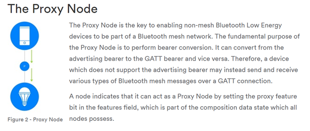

Look this picture, I'm wondering why proxy node is in the middle, not as a layer in ble program running on the smart phone?
It is possible, right?
As the text says, the whole point is to allow devices which do not support Mesh to access a Mesh network.
"does not support Mesh" means that you can't just do it in software!
On a mobile phone, "does not support Mesh" could mean:
If it's just a matter of OS support, then you might be able to add support in software - but would probably have to "jailbreak" the device
Got it, thanks.
