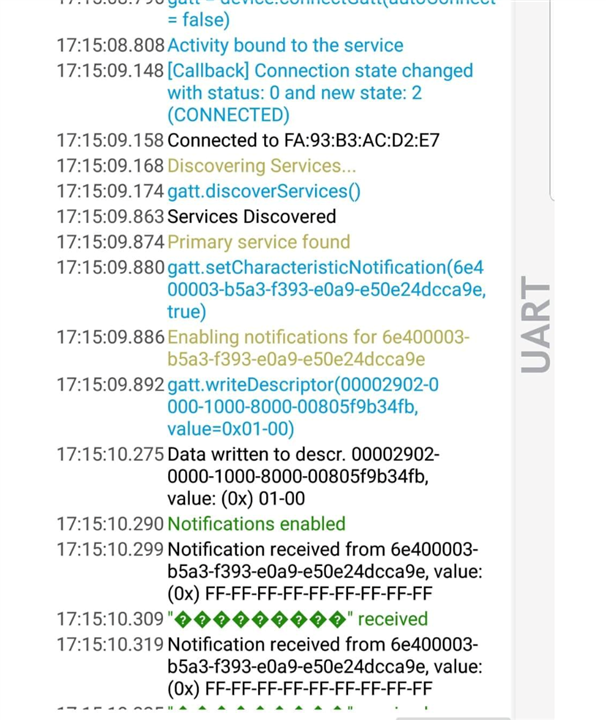

Although the project builds and flashes fine (and the device advertising and connects), the data I am getting is either nothing or a fixed array of "0xFF-FF-FF-FF-FF-FF-FF-FF-FF". What are possible problems that could be causing this? I am a little confused because I made sure the same SPI data transfer code works in a simple SPI example project.  I checked all my SPI pins seem to be working as expected in an oscilloscope. At least I am getting a proper clock signal, Master output pulses and an active low chip select while the device is connected to the app.

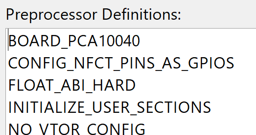

  • Pin 9,10 are usually NFCT by default. So I added this to preprocessor definitions
    along with editing the UICR_config file according to instructions I read on other devzone posts for pin 9 configuration. I did this so I can use 9,10 for my SPI.

    My RTT log shows proper data once when I first open it, like an array of '1E007F' which seems like normal ADC data, but then it would go back to printing out 'FF...FFFFFF01'
  • I set my spi_config.orc = 0x55; but that did not change the "0xFFF..." output I am seeing, so I am guessing this isn't an overflow problem
