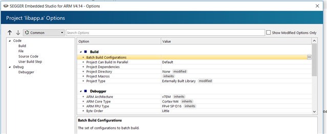

I need to add ARM_MATH_CM4 to my preprocessor definitions using Segger Embedded Studio.
I know this has been dealt with in "nRF52832: How to Include the "arm_math.h" library"
However, the SES Project->Options in that answers shows a "Preprocesor" selection under "Code".
On my screen for Project->Options under "Code" it only has 4 selection "Build", "File", "General" and "Source Code".
What am missing/failing to do?

    This project was created by following the directions in "NRF Connect" "Getting Started Assistant".
    Also, my version of the "asset_tracker" project (built following the same directions and which runs successfully), does not show a "Preprocesor" selection under "Code" either.
    Could this be some setting in emStudio instead of something project-based?
  • This is a nRF52840 project which I am developing on the nRF52840 DK.  It is based on a previously working nRF52840 project to which we now want to add Zephyr.  At the suggestion of Simon (in a different case) I built this new nRF52840 project by following the instructions in "Getting Started" which lists how to clone Zephyr, the nrf libraries etc.  The project now builds with Zephyr but it will not compile the processing module because of the missing math library.
    I note again, that I also have built the "asset_tracker" project example.  It is working.  As I built it, the project options look like the snap shot I attached above; there is no "Preprocessing" selection under "Code".  So whatever is happening - whatever building step I missed or did incorrectly - is not fixed by starting with a Nordic project as a template.

    If I build an emStudio project using File->New Project..., I get a project with the full set of "Options" under "Code".  If I then do a "File->Open NRF SDK Connect Project..., these options no longer exist and the project options look like the snap shot attached at the beginning of this case.
    In other words, if I try to get Zephyr into the my project build using "Open NRF SDK Connect Project...", it actually removes the project options and changes the options possibly by changing the Common Configuration file.

  • My original question is how to build a zephyr project for nRF52840 (initially I will run on nRF52840 DK) using Segger Embedded Studio.  Neither of your suggestions involves SES.
    The problem is getting SES to include and build the Zephyr files as part of the project.  I managed to make this happen by following the Getting Started instructions for the "asset_tracker" project, but I now know that the "Open NRF SDK Connect Project..." menu selection changes the configuration so I no longer have access to important project options like "Preprocesor".  (Why does this happen?)  I need to modify "Preprocess" options so I can get the project to include the ARM math libraries.
