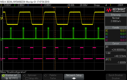

Here is a snipped of an oscilloscope reading. The timer handle is called every 25 us to toggle between +4V and -4V (square wave signal is 20 KHz). The yellow line is the AD5721 output voltage. The green line is the clock (24 bit, 3us), and the violet line is the SS (SYNC).

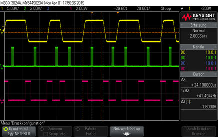

Problem: As soon as I decrease the timer tick events below 25 us (here 22 us for a period of 22.73 kHz) I get a square wave signal with an incorrect duty cycle. This can be seen in the oscilloscope image below.
Why isn’t the SYNC brought up to high again directly after the clock and data transfer has ended? Is this a similar problem like this Q&A: https://devzone.nordicsemi.com/f/nordic-q-a/9636/spi-clock-bug. ?

    The timer handler works fine to toggle a specific pin. Once the SPI handler is running the pin toggle also differs in duration. I’m starting to wonder if the DAC is limiting the frequency output.
