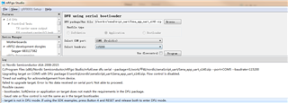

I test the uart dfu by examples\dfu\secure_bootloader\pca10056_uart
After I enter command like below:
nrfutil dfu serial -pkg Sena_app_uart_s140.zip -p COM5 -b 115200
then there is no response....
My environment is as below:
nRF5_SDK_15.3.0_59ac345, s140_nrf52_6.1.1_softdevice,  keil5, computer os is win7.
I use .bat file to program bin to flash.

By the way,BLE DFU and USB DFU are both ok on my board.....
Do I need to program mbr.hex??  if so ,how can I get ths file and program.
