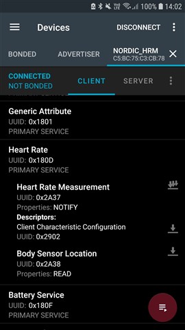

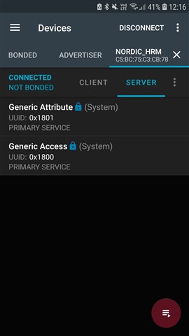

The padlock is indicating that it's non configurable and set by the system. This is not something that can be changed by the user. You can access the services of a peripheral by changing to the client column.
Best regards
Jared
EDIT: The server tab displays services locally on the phone that can be customized in Navigation Menu -> Configure GATT Server

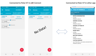

I'm not sure I get what you mean.
Using another app, I can connect to the device and list services and characteristics. As well as enable notifications etc.
In nRF Connct I can't even see the heart rate service.

I'm using nRF Connect version 4.22.3 on both devices.
I do not have a nRF51 och 52.
I noticed the isse developing a program for the ESP32 using esp idf.
But I have the same issue with any other sensor, Polar H7, Cadense etc..
I'm not running Auto service discovery.
Automatic service discovery is enabled by default. If disabled, in Settings -> Connectivity -> Automatic service discovery, you need to initiate service discovery manually, by selecting the menu in top right corner and choosing Discover Services.
