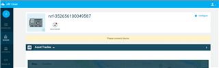

nRF9160 DK Asset Tracker nrf_cloud_connect failed: -111
I recently got past an issue with not connecting to the LTE network getting an nrf_cloud_connect failed: 60 and had things working yesterday.  I had support for that issue in case 222766 (https://devzone.nordicsemi.com/support/222766), helped by @Øyvind.
I went back to try things today and am getting a different error:
From looking at DevZone it appears that this error is for Connection Refused and can happen when all of the 10MB of data gets used up for the provided iBasis SIM.  I did inadvertently leave the board running for a few hours yesterday, so this might be possible, though I'm not certain of the position of SW2 at the time, which determines if messages are sent or not.
The FAQ for iBasis on DevZone (https://devzone.nordicsemi.com/b/nrf9160-development-status/posts/ibasis-global-access-for-things-frequently-asked-questions-faq) says:

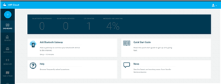

1. Q: How can I determine how much data is left in my current data plan?
    A: Your nRF Cloud LTE device dashboard will show the status of your nRF9160 Development Board along with the percent of data remaining in your current plan.
2. Q: How can I purchase more cellular data from the iBasis Global Access for Things worldwide cellular IoT service?
    A: A “Buy More Data” button will appear at the top of your nRF Cloud LTE device dashboard when your current data plan is almost depleted.  When you select the “Buy More Data” button, a data “Top-Up” page will be launched allowing you to select and pre-pay for a Top-Up data plan with your credit card.
But on nRF Cloud I don't get anything showing the percent of remaining data in my plan, nor do I get a Buy More Data button at the top of the device dashboard.
So, I can't tell if I've used up my data or not.  How do I figure out what's wrong?

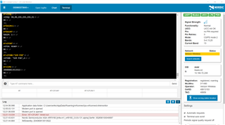

Here is the output from the nRF Cloud terminal.
AT+CFUN?

I also loaded the AT Client and see this:
AT+CFUN?
AT+CFUN?
***** Booting Zephyr OS v1.13.99-ncs1-5025-g745326266d9c *****
Secure Boot: configure flash
Secure Boot: SPU: set region 0 as Secure
Secure Boot: SPU: set region 1 as Secure
Secure Boot: SPU: set region 2 as Secure
Secure Boot: SPU: set region 3 as Secure
Secure Boot: SPU: set region 4 as Secure
Secure Boot: SPU: set region 5 as Secure
Secure Boot: SPU: set region 6 as Secure
Secure Boot: SPU: set region 7 as Secure
Secure Boot: SPU: set Flash region 8 as Non-Secure
Secure Boot: SPU: set Flash region 9 as Non-Secure
Secure Boot: SPU: set Flash region 10 as Non-Secure
Secure Boot: SPU: set Flash region 11 as Non-Secure
Secure Boot: SPU: set Flash region 12 as Non-Secure
Secure Boot: SPU: set Flash region 13 as Non-Secure
Secure Boot: SPU: set Flash region 14 as Non-Secure
Secure Boot: SPU: set Flash region 15 as Non-Secure
Secure Boot: SPU: set Flash region 16 as Non-Secure
Secure Boot: SPU: set Flash region 17 as Non-Secure
Secure Boot: SPU: set Flash region 18 as Non-Secure
Secure Boot: SPU: set Flash region 19 as Non-Secure
Secure Boot: SPU: set Flash region 20 as Non-Secure
Secure Boot: SPU: set Flash region 21 as Non-Secure
Secure Boot: SPU: set Flash region 22 as Non-Secure
Secure Boot: SPU: set Flash region 23 as Non-Secure
Secure Boot: SPU: set Flash region 24 as Non-Secure
Secure Boot: SPU: set Flash region 25 as Non-Secure
Secure Boot: SPU: set Flash region 26 as Non-Secure
Secure Boot: SPU: set Flash region 27 as Non-Secure
Secure Boot: SPU: set Flash region 28 as Non-Secure
Secure Boot: SPU: set Flash region 29 as Non-Secure
Secure Boot: SPU: set Flash region 30 as Non-Secure
Secure Boot: SPU: set Flash region 31 as Non-Secure
Secure Boot: configure SRAM
Secure Boot: SPU: set SRAM region 0 as Secure
Secure Boot: SPU: set SRAM region 1 as Secure
Secure Boot: SPU: set SRAM region 2 as Secure
Secure Boot: SPU: set SRAM region 3 as Secure
Secure Boot: SPU: set SRAM region 4 as Secure
Secure Boot: SPU: set SRAM region 5 as Secure
Secure Boot: SPU: set SRAM region 6 as Secure
Secure Boot: SPU: set SRAM region 7 as Secure
Secure Boot: SPU: set SRAM region 8 as Non-Secure
Secure Boot: SPU: set SRAM region 9 as Non-Secure
Secure Boot: SPU: set SRAM region 10 as Non-Secure
Secure Boot: SPU: set SRAM region 11 as Non-Secure
Secure Boot: SPU: set SRAM region 12 as Non-Secure
Secure Boot: SPU: set SRAM region 13 as Non-Secure
Secure Boot: SPU: set SRAM region 14 as Non-Secure
Secure Boot: SPU: set SRAM region 15 as Non-Secure
Secure Boot: SPU: set SRAM region 16 as Non-Secure
Secure Boot: SPU: set SRAM region 17 as Non-Secure
Secure Boot: SPU: set SRAM region 18 as Non-Secure
Secure Boot: SPU: set SRAM region 19 as Non-Secure
Secure Boot: SPU: set SRAM region 20 as Non-Secure
Secure Boot: SPU: set SRAM region 21 as Non-Secure
Secure Boot: SPU: set SRAM region 22 as Non-Secure
Secure Boot: SPU: set SRAM region 23 as Non-Secure
Secure Boot: SPU: set SRAM region 24 as Non-Secure
Secure Boot: SPU: set SRAM region 25 as Non-Secure
Secure Boot: SPU: set SRAM region 26 as Non-Secure
Secure Boot: SPU: set SRAM region 27 as Non-Secure
Secure Boot: SPU: set SRAM region 28 as Non-Secure
Secure Boot: SPU: set SRAM region 29 as Non-Secure
Secure Boot: SPU: set SRAM region 30 as Non-Secure
Secure Boot: SPU: set SRAM region 31 as Non-Secure
Secure Boot: configure peripherals
Secure Boot: MSP_NS 200265f0
Secure Boot: prepare to jump to Non-Secure image
***** Booting Zephyr OS v1.13.99-ncs2 *****
The AT host sample started
AT+CFUN?
+CFUN: 4
OK
AT+CFUN=1
OK
AT+CFUN?
+CFUN: 1
OK
AT+CGSN=1
+CGSN: "352656100049587"
OK
AT+CGMI
Nordic Semiconductor ASA
OK
AT+CGMM
nRF9160
OK
AT+CGMR
mfw-m1_nrf9160_0.6.8-131.alpha
OK
AT+CEMODE?
+CEMODE: 2
OK
AT%XCBAND=?
%XCBAND: (3,4,13,20)
OK
AT+CMEE?
+CMEE: 0
OK
AT+CMEE=1
OK
AT+CNEC?
+CNEC: 0
OK
AT+CNEC=24
OK
AT+CGEREP?
+CGEREP: 0,0
OK
AT+CGDCONT?
+CGDCONT: 0,"IP","ibasis.iot","10.160.72.248",0,0
OK
AT+CGACT?
+CGACT: 0,1
OK
AT+CGEREP=1
OK
AT+CIND=1,1,1
OK
AT+CEREG=2
OK
AT+CEREG?
+CEREG: 2,5,"BF3F","02EA5B01",7
OK
AT+COPS=3,2
OK
AT+COPS?
+COPS: 0,2,"311480",7
OK
AT%XCBAND
%XCBAND: 13
OK
AT+CGDCONT?
OK
AT+CGACT?
+CGACT: 0,1
OK
AT%CESQ=1
OK
AT+CESQ
+CESQ: 99,99,255,255,255,31
OK
AT%XSIM=1
OK
AT%XSIM?
%XSIM: 1
OK
AT+CPIN?
+CPIN: READY
OK
AT+CPINR="SIM PIN"
+CPINR: "SIM PIN",3
OK
AT+CIMI
204080813513522
OK
I have also attached my nRF Connect log file for today.

2019-04-14T17:05:31.700Z DEBUG modem << LTE LC config ...\x0D\x0A
2019-04-14T17:05:47.689Z DEBUG modem << nrf_cloud_connect failed: -111\x0D\x0A

2019-04-14T17:06:28.410Z DEBUG modem << nrf_cloud_connect failed: -111\x0D\x0A
2019-04-14T17:21:06.609Z INFO Modem port is opened
2019-04-14T17:21:06.614Z DEBUG modem >> AT+CFUN?\x0D\x0A
2019-04-14T17:21:12.033Z DEBUG modem >> AT+CFUN?\x0D\x0A
2019-04-14T17:21:13.034Z ERROR Error: 'AT+CFUN?
' timed out
2019-04-14T17:21:15.137Z DEBUG modem << ***** Booting Zephyr OS v1.13.99-ncs1-5025-g745326266d9c *****\x0D\x0A
2019-04-14T17:21:15.152Z DEBUG modem << Secure Boot: configure flash\x0D\x0A
2019-04-14T17:21:15.156Z DEBUG modem << Secure Boot: SPU: set region 0 as Secure\x0D\x0A
2019-04-14T17:21:15.159Z DEBUG modem << Secure Boot: SPU: set region 1 as Secure\x0D\x0A
2019-04-14T17:21:15.162Z DEBUG modem << Secure Boot: SPU: set region 2 as Secure\x0D\x0A
2019-04-14T17:21:15.164Z DEBUG modem << Secure Boot: SPU: set region 3 as Secure\x0D\x0A
2019-04-14T17:21:15.166Z DEBUG modem << Secure Boot: SPU: set region 4 as Secure\x0D\x0A
2019-04-14T17:21:15.180Z DEBUG modem << Secure Boot: SPU: set region 5 as Secure\x0D\x0A
2019-04-14T17:21:15.182Z DEBUG modem << Secure Boot: SPU: set region 6 as Secure\x0D\x0A
2019-04-14T17:21:15.186Z DEBUG modem << Secure Boot: SPU: set region 7 as Secure\x0D\x0A
2019-04-14T17:21:15.189Z DEBUG modem << Secure Boot: SPU: set Flash region 8 as Non-Secure\x0D\x0A
2019-04-14T17:21:15.191Z DEBUG modem << Secure Boot: SPU: set Flash region 9 as Non-Secure\x0D\x0A
2019-04-14T17:21:15.193Z DEBUG modem << Secure Boot: SPU: set Flash region 10 as Non-Secure\x0D\x0A
2019-04-14T17:21:15.205Z DEBUG modem << Secure Boot: SPU: set Flash region 11 as Non-Secure\x0D\x0A
2019-04-14T17:21:15.208Z DEBUG modem << Secure Boot: SPU: set Flash region 12 as Non-Secure\x0D\x0A
2019-04-14T17:21:15.223Z DEBUG modem << Secure Boot: SPU: set Flash region 13 as Non-Secure\x0D\x0A
2019-04-14T17:21:15.226Z DEBUG modem << Secure Boot: SPU: set Flash region 14 as Non-Secure\x0D\x0A
2019-04-14T17:21:15.229Z DEBUG modem << Secure Boot: SPU: set Flash region 15 as Non-Secure\x0D\x0A
2019-04-14T17:21:15.232Z DEBUG modem << Secure Boot: SPU: set Flash region 16 as Non-Secure\x0D\x0A
2019-04-14T17:21:15.248Z DEBUG modem << Secure Boot: SPU: set Flash region 17 as Non-Secure\x0D\x0A
2019-04-14T17:21:15.251Z DEBUG modem << Secure Boot: SPU: set Flash region 18 as Non-Secure\x0D\x0A
2019-04-14T17:21:15.253Z DEBUG modem << Secure Boot: SPU: set Flash region 19 as Non-Secure\x0D\x0A
2019-04-14T17:21:15.255Z DEBUG modem << Secure Boot: SPU: set Flash region 20 as Non-Secure\x0D\x0A
2019-04-14T17:21:15.257Z DEBUG modem << Secure Boot: SPU: set Flash region 21 as Non-Secure\x0D\x0A
2019-04-14T17:21:15.274Z DEBUG modem << Secure Boot: SPU: set Flash region 22 as Non-Secure\x0D\x0A
2019-04-14T17:21:15.279Z DEBUG modem << Secure Boot: SPU: set Flash region 23 as Non-Secure\x0D\x0A
2019-04-14T17:21:15.281Z DEBUG modem << Secure Boot: SPU: set Flash region 24 as Non-Secure\x0D\x0A
2019-04-14T17:21:15.284Z DEBUG modem << Secure Boot: SPU: set Flash region 25 as Non-Secure\x0D\x0A
2019-04-14T17:21:15.285Z DEBUG modem << Secure Boot: SPU: set Flash region 26 as Non-Secure\x0D\x0A
2019-04-14T17:21:15.287Z DEBUG modem << Secure Boot: SPU: set Flash region 27 as Non-Secure\x0D\x0A
2019-04-14T17:21:15.303Z DEBUG modem << Secure Boot: SPU: set Flash region 28 as Non-Secure\x0D\x0A
2019-04-14T17:21:15.306Z DEBUG modem << Secure Boot: SPU: set Flash region 29 as Non-Secure\x0D\x0A
2019-04-14T17:21:15.308Z DEBUG modem << Secure Boot: SPU: set Flash region 30 as Non-Secure\x0D\x0A
2019-04-14T17:21:15.312Z DEBUG modem << Secure Boot: SPU: set Flash region 31 as Non-Secure\x0D\x0A
2019-04-14T17:21:15.314Z DEBUG modem << Secure Boot: configure SRAM\x0D\x0A
2019-04-14T17:21:15.316Z DEBUG modem << Secure Boot: SPU: set SRAM region 0 as Secure\x0D\x0A
2019-04-14T17:21:15.318Z DEBUG modem << Secure Boot: SPU: set SRAM region 1 as Secure\x0D\x0A
2019-04-14T17:21:15.333Z DEBUG modem << Secure Boot: SPU: set SRAM region 2 as Secure\x0D\x0A
2019-04-14T17:21:15.336Z DEBUG modem << Secure Boot: SPU: set SRAM region 3 as Secure\x0D\x0A
2019-04-14T17:21:15.338Z DEBUG modem << Secure Boot: SPU: set SRAM region 4 as Secure\x0D\x0A
2019-04-14T17:21:15.340Z DEBUG modem << Secure Boot: SPU: set SRAM region 5 as Secure\x0D\x0A
2019-04-14T17:21:15.342Z DEBUG modem << Secure Boot: SPU: set SRAM region 6 as Secure\x0D\x0A
2019-04-14T17:21:15.344Z DEBUG modem << Secure Boot: SPU: set SRAM region 7 as Secure\x0D\x0A
2019-04-14T17:21:15.347Z DEBUG modem << Secure Boot: SPU: set SRAM region 8 as Non-Secure\x0D\x0A
2019-04-14T17:21:15.362Z DEBUG modem << Secure Boot: SPU: set SRAM region 9 as Non-Secure\x0D\x0A
2019-04-14T17:21:15.365Z DEBUG modem << Secure Boot: SPU: set SRAM region 10 as Non-Secure\x0D\x0A
2019-04-14T17:21:15.368Z DEBUG modem << Secure Boot: SPU: set SRAM region 11 as Non-Secure\x0D\x0A
2019-04-14T17:21:15.370Z DEBUG modem << Secure Boot: SPU: set SRAM region 12 as Non-Secure\x0D\x0A
2019-04-14T17:21:15.372Z DEBUG modem << Secure Boot: SPU: set SRAM region 13 as Non-Secure\x0D\x0A
2019-04-14T17:21:15.374Z DEBUG modem << Secure Boot: SPU: set SRAM region 14 as Non-Secure\x0D\x0A
2019-04-14T17:21:15.388Z DEBUG modem << Secure Boot: SPU: set SRAM region 15 as Non-Secure\x0D\x0A
2019-04-14T17:21:15.392Z DEBUG modem << Secure Boot: SPU: set SRAM region 16 as Non-Secure\x0D\x0A
2019-04-14T17:21:15.396Z DEBUG modem << Secure Boot: SPU: set SRAM region 17 as Non-Secure\x0D\x0A
2019-04-14T17:21:15.398Z DEBUG modem << Secure Boot: SPU: set SRAM region 18 as Non-Secure\x0D\x0A
2019-04-14T17:21:15.400Z DEBUG modem << Secure Boot: SPU: set SRAM region 19 as Non-Secure\x0D\x0A
2019-04-14T17:21:15.402Z DEBUG modem << Secure Boot: SPU: set SRAM region 20 as Non-Secure\x0D\x0A
2019-04-14T17:21:15.417Z DEBUG modem << Secure Boot: SPU: set SRAM region 21 as Non-Secure\x0D\x0A
2019-04-14T17:21:15.420Z DEBUG modem << Secure Boot: SPU: set SRAM region 22 as Non-Secure\x0D\x0A
2019-04-14T17:21:15.422Z DEBUG modem << Secure Boot: SPU: set SRAM region 23 as Non-Secure\x0D\x0A
2019-04-14T17:21:15.425Z DEBUG modem << Secure Boot: SPU: set SRAM region 24 as Non-Secure\x0D\x0A
2019-04-14T17:21:15.431Z DEBUG modem << Secure Boot: SPU: set SRAM region 25 as Non-Secure\x0D\x0A
2019-04-14T17:21:15.433Z DEBUG modem << Secure Boot: SPU: set SRAM region 26 as Non-Secure\x0D\x0A
2019-04-14T17:21:15.450Z DEBUG modem << Secure Boot: SPU: set SRAM region 27 as Non-Secure\x0D\x0A
2019-04-14T17:21:15.452Z DEBUG modem << Secure Boot: SPU: set SRAM region 28 as Non-Secure\x0D\x0A
2019-04-14T17:21:15.455Z DEBUG modem << Secure Boot: SPU: set SRAM region 29 as Non-Secure\x0D\x0A
2019-04-14T17:21:15.457Z DEBUG modem << Secure Boot: SPU: set SRAM region 30 as Non-Secure\x0D\x0A
2019-04-14T17:21:15.460Z DEBUG modem << Secure Boot: SPU: set SRAM region 31 as Non-Secure\x0D\x0A
2019-04-14T17:21:15.462Z DEBUG modem << Secure Boot: configure peripherals\x0D\x0A
2019-04-14T17:21:15.464Z DEBUG modem << Secure Boot: MSP_NS 200265f0\x0D\x0A
2019-04-14T17:21:15.466Z DEBUG modem << Secure Boot: prepare to jump to Non-Secure image\x0D\x0A
2019-04-14T17:21:16.254Z DEBUG modem << ***** Booting Zephyr OS v1.13.99-ncs2 *****\x0D\x0A
2019-04-14T17:21:16.270Z DEBUG modem << The AT host sample started\x0D\x0A
2019-04-14T17:21:22.447Z DEBUG modem >> AT+CFUN?\x0D\x0A
2019-04-14T17:21:22.471Z DEBUG modem << +CFUN: 4\x0D\x0A
2019-04-14T17:21:22.484Z DEBUG modem << OK\x0D
2019-04-14T17:21:22.500Z DEBUG modem >> AT+CFUN=1\x0D\x0A
2019-04-14T17:21:22.519Z DEBUG modem << OK\x0D\x0A\x00
2019-04-14T17:21:43.449Z DEBUG modem >> AT+CFUN?\x0D\x0A
2019-04-14T17:21:43.465Z DEBUG modem << +CFUN: 1\x0D\x0A
2019-04-14T17:21:43.475Z DEBUG modem << OK\x0D\x0A\x00
2019-04-14T17:21:43.491Z DEBUG modem >> AT+CGSN=1\x0D\x0A
2019-04-14T17:21:43.513Z DEBUG modem << +CGSN: "352656100049587"\x0D\x0A
2019-04-14T17:21:43.516Z DEBUG modem << OK\x0D\x0A\x00
2019-04-14T17:21:43.535Z DEBUG modem >> AT+CGMI\x0D\x0A
2019-04-14T17:21:43.551Z DEBUG modem << Nordic Semiconductor ASA\x0D\x0A
2019-04-14T17:21:43.555Z DEBUG modem << OK\x0D\x0A\x00
2019-04-14T17:21:43.573Z DEBUG modem >> AT+CGMM\x0D\x0A
2019-04-14T17:21:43.593Z DEBUG modem << nRF9160\x0D\x0A
2019-04-14T17:21:43.598Z DEBUG modem << OK\x0D\x0A\x00
2019-04-14T17:21:43.603Z DEBUG modem >> AT+CGMR\x0D\x0A
2019-04-14T17:21:43.625Z DEBUG modem << mfw-m1_nrf9160_0.6.8-131.alpha\x0D\x0A
2019-04-14T17:21:43.628Z DEBUG modem << OK\x0D\x0A\x00
2019-04-14T17:21:43.631Z INFO Nordic Semiconductor ASA nRF9160 [mfw-m1_nrf9160_0.6.8-131.alpha] SerNr: 352656100049587
2019-04-14T17:21:43.633Z DEBUG modem >> AT+CEMODE?\x0D\x0A
2019-04-14T17:21:43.650Z DEBUG modem << +CEMODE: 2\x0D\x0A
2019-04-14T17:21:43.657Z DEBUG modem << OK\x0D\x0A\x00
2019-04-14T17:21:43.677Z DEBUG modem >> AT%XCBAND=?\x0D\x0A
2019-04-14T17:21:43.697Z DEBUG modem << %XCBAND: (3,4,13,20)\x0D\x0A
2019-04-14T17:21:43.701Z DEBUG modem << OK\x0D\x0A\x00
2019-04-14T17:21:43.725Z DEBUG modem >> AT+CMEE?\x0D\x0A
2019-04-14T17:21:43.746Z DEBUG modem << +CMEE: 0\x0D\x0A
2019-04-14T17:21:43.749Z DEBUG modem << OK\x0D\x0A\x00
2019-04-14T17:21:43.767Z DEBUG modem >> AT+CMEE=1\x0D\x0A
2019-04-14T17:21:43.791Z DEBUG modem << OK\x0D\x0A\x00
2019-04-14T17:21:43.796Z DEBUG modem >> AT+CNEC?\x0D\x0A
2019-04-14T17:21:43.830Z DEBUG modem << +CNEC: 0\x0D
2019-04-14T17:21:43.834Z DEBUG modem << \x0A
2019-04-14T17:21:43.838Z DEBUG modem << OK\x0D\x0A\x00
2019-04-14T17:21:43.857Z DEBUG modem >> AT+CNEC=24\x0D\x0A
2019-04-14T17:21:43.878Z DEBUG modem << OK\x0D\x0A\x00
2019-04-14T17:21:43.883Z DEBUG modem >> AT+CGEREP?\x0D\x0A
2019-04-14T17:21:43.906Z DEBUG modem << +CGEREP: 0,0\x0D\x0A
2019-04-14T17:21:43.910Z DEBUG modem << OK\x0D\x0A\x00
2019-04-14T17:21:43.916Z DEBUG modem >> AT+CGDCONT?\x0D\x0A
2019-04-14T17:21:43.937Z DEBUG modem << +CGDCONT: 0,"IP","ibasis.iot","10.160.72.248",0,0\x0D\x0A
2019-04-14T17:21:43.941Z DEBUG modem << OK\x0D\x0A\x00
2019-04-14T17:21:43.948Z DEBUG modem >> AT+CGACT?\x0D\x0A
2019-04-14T17:21:43.966Z DEBUG modem << +CGACT: 0,1\x0D\x0A
2019-04-14T17:21:43.972Z DEBUG modem << OK\x0D\x0A\x00
2019-04-14T17:21:43.993Z DEBUG modem >> AT+CGEREP=1\x0D\x0A
2019-04-14T17:21:44.011Z DEBUG modem << OK\x0D\x0A\x00
2019-04-14T17:21:44.017Z DEBUG modem >> AT+CIND=1,1,1\x0D\x0A
2019-04-14T17:21:44.035Z DEBUG modem << OK\x0D
2019-04-14T17:21:44.056Z DEBUG modem >> AT+CEREG=2\x0D\x0A
2019-04-14T17:21:44.076Z DEBUG modem << OK\x0D\x0A\x00
2019-04-14T17:21:44.081Z DEBUG modem >> AT+CEREG?\x0D\x0A
2019-04-14T17:21:44.116Z DEBUG modem << +CEREG: 2,5,"BF3F","02EA5B01",7\x0D\x0A
2019-04-14T17:21:44.120Z DEBUG modem << OK\x0D\x0A\x00
2019-04-14T17:21:44.145Z DEBUG modem >> AT+COPS=3,2\x0D\x0A
2019-04-14T17:21:44.164Z DEBUG modem << OK\x0D\x0A\x00
2019-04-14T17:21:44.171Z DEBUG modem >> AT+COPS?\x0D\x0A
2019-04-14T17:21:44.193Z DEBUG modem << +COPS: 0,2,"311480",7\x0D\x0A
2019-04-14T17:21:44.196Z DEBUG modem << OK\x0D\x0A\x00
2019-04-14T17:21:44.202Z DEBUG modem >> AT%XCBAND\x0D\x0A
2019-04-14T17:21:44.225Z DEBUG modem << %XCBAND: 13\x0D
2019-04-14T17:21:44.229Z DEBUG modem << \x0A
2019-04-14T17:21:44.231Z DEBUG modem << OK\x0D\x0A\x00
2019-04-14T17:21:44.256Z DEBUG modem >> AT+CGDCONT?\x0D\x0A
2019-04-14T17:21:44.279Z DEBUG modem << +CGDCONT: 0,"IP","ibasis.iot","10.160.72.248",0,0\x0D\x0A
2019-04-14T17:21:44.283Z DEBUG modem << OK\x0D\x0A\x00
2019-04-14T17:21:44.309Z DEBUG modem >> AT+CGACT?\x0D\x0A
2019-04-14T17:21:44.330Z DEBUG modem << +CGACT: 0,1\x0D\x0A
2019-04-14T17:21:44.333Z DEBUG modem << OK\x0D\x0A\x00
2019-04-14T17:21:44.357Z DEBUG modem >> AT%CESQ=1\x0D\x0A
2019-04-14T17:21:44.377Z DEBUG modem << OK\x0D\x0A\x00
2019-04-14T17:21:44.383Z DEBUG modem >> AT+CESQ\x0D\x0A
2019-04-14T17:21:44.407Z DEBUG modem << +CESQ: 99,99,255,255,255,31\x0D\x0A
2019-04-14T17:21:44.411Z DEBUG modem << OK\x0D\x0A\x00
2019-04-14T17:21:44.433Z DEBUG modem >> AT%XSIM=1\x0D\x0A
2019-04-14T17:21:44.457Z DEBUG modem << OK\x0D
2019-04-14T17:21:44.476Z DEBUG modem >> AT%XSIM?\x0D\x0A
2019-04-14T17:21:44.500Z DEBUG modem << %XSIM: 1\x0D\x0A
2019-04-14T17:21:44.506Z DEBUG modem << OK\x0D\x0A\x00
2019-04-14T17:21:44.529Z DEBUG modem >> AT+CPIN?\x0D\x0A
2019-04-14T17:21:44.551Z DEBUG modem << +CPIN: READY\x0D\x0A
2019-04-14T17:21:44.558Z DEBUG modem << OK\x0D\x0A\x00
2019-04-14T17:21:44.581Z DEBUG modem >> AT+CPINR="SIM PIN"\x0D\x0A
2019-04-14T17:21:44.601Z DEBUG modem << +CPINR: "SIM PIN",3\x0D\x0A
2019-04-14T17:21:44.625Z DEBUG modem << OK\x0D\x0A\x00
2019-04-14T17:21:44.632Z DEBUG modem >> AT+CIMI\x0D\x0A
2019-04-14T17:21:44.657Z DEBUG modem << 204080813513522\x0D\x0A
2019-04-14T17:21:44.661Z DEBUG modem << OK\x0D\x0A\x00
2019-04-14T17:21:44.664Z INFO IMSIdentity: 204080813513522
What's my next step to now resolve this issue?
Erik
