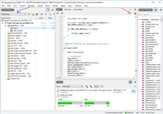

    No, you should use a debugger (the same device you use to flash the nRF), and this will allow you to set breakpoints and inspect memory of the running application. For instance if you are using SES, you can start debugging by clicking the button pointed to by the red arrow to the right here (also note the blue arrow on the left side, selecting the debug configuration):

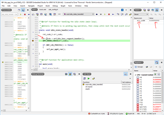

    Now I set a breakpoint on the line after the error code I am interested in, and run the application until it hits the breakpoint. Then I can hover over the variable with the mouse to see it's value, or right click and add it to watch as shown here:
    In this case you can see that the err_code value is 0, which is NRF_SUCCESS (meaning all OK).
    Using such and other debugging techniques is necessary to understand what is going on when you have something not working with your application.
