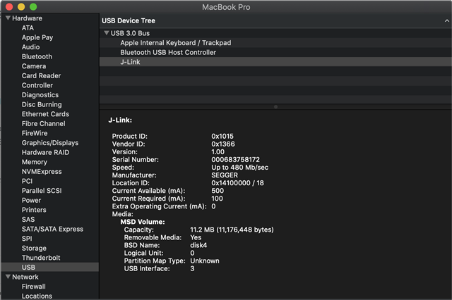

Hi I purchased nRF52840-DK board recently. I'm able to connect it to Mac OS Mojave and I see that the LED5 is blinking every second. However none of the LED1-4 are blinking and I'm not sure what to do here. I followed the steps listed out here - https://www.nordicsemi.com/Software-and-Tools/Development-Kits/nRF52-DK/Getting-Started
and I downloaded the latest firmware and drag-dropped the hex file into the JLINK drive that I see in the file explorer but it didn't work.
Can you please help me?
Thanks, Raghav
  • Also I'm able to see JLink listed in System Information
