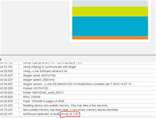

  • How to check which softDevice stack is running on my DK?
    You can e.g. check it with nRF Connect programmer app:
    If you need to check it run-time, then it's defined in nrf_sdm.h as well, see this link.

  • Yes, nRF connect app is helpful for me to detect the stack. Thanks.
