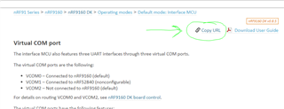

    The link you sent is unfortunately "broken", or at least shows the front page of the "nRF9160 DK".
    If you want to link to something in "infocenter" please make sure to use the "Copy URL" button to get the correct URL for your selected page:

    Sorry about the link. There is no "Copy URL" at the specific page in Chrome or Edge, but here's the path: nRF91 Series -> nRF9160 -> nRF9160 Object Product Specification -> LTE Modem -> Introduction.
