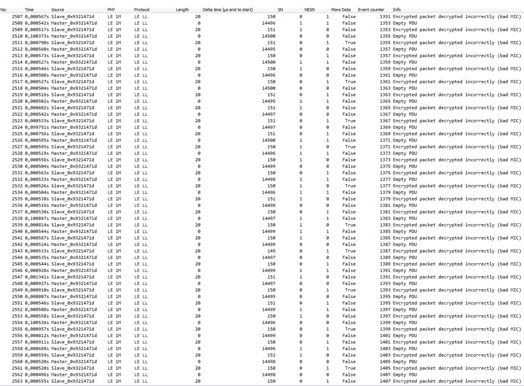

    thanks for the reply.
    I went through the various steps to get the sniffer running under wireshark.. Although I followed all the steps in the troubleshooting area (checking the jlink version on the firmware, running the "sethwfc force" option and so on) the tool chain does not work properly. I need several starting retries to finally receive packets after activating the COM port.
    However, even then there seems to be a problem remaining, because all advertising packets show "length is incorrect" under header->length of payload (s. screenshot below).
    I'm using Wireshark Version 2.4.2 and Sniffer v2_001. The sniffer firmware runs on a NRF52 DK (PCA10040).
    Do you have any ideas what causes this behaviour?
    (The marked packet in the screenshot does not relate to my device, it is just examplatory... All received advertising messages are shown in that way).
