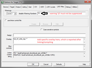

    Could you also check if there are any data overlays that needs to be handled in your compiler? I assume you use Keil C51?
    You'll need warning L15 enabled in order to see the potential functions that overlay in memory. If you get any L15 warnings when you recompile (rebuild the whole project, not incremental build), please post them here.

    I don't use Keil. It is SDCC.

    I have to admit that my sdcc knowledge have deteriorated over the years, but I believe it has the same principles wrt. reentrancy as Keil C51, just with different naming:
    https://github.com/contiki-os/contiki/wiki/8051-Memory-Spaces#SDCC_Memory_Models_Variables_Function_Parameters_and_the_Stack
    Since you mention that this issue seems to occur if several things happen at the same time:
    If you do not compile with --stack-auto, all auto-variables will be placed similar to a static/global variable. Thus, if you have a function that is called from both main-context and interrupt-context, you have to make sure that this specific function is reentrant to avoid the variable being overwritten by the interrupt. I do not know if you use interrupts at all, but if you do any processing in interrupt, where the specific function calls will overlay with the main context, there will be a chance that your memory will be corrupted.
