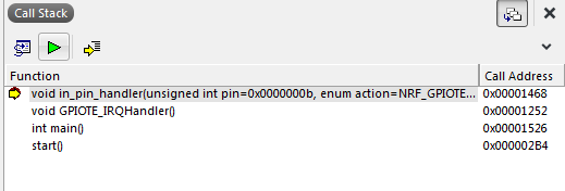

Where is the interrupt get serviced in the code? There is no interrupt_handler() routine.
It's in nrfx_gpiote_irq_handler(). From the vector table, you have the GPIOTE_IRQHandler, and in nrfx_irqs_nrf52840.h, we have that
#define nrfx_gpiote_irq_handler GPIOTE_IRQHandler
and nrfx_gpiote_irq_handler() can be found in nrfx driver folder in nrfx_gpiote.c. See this link.
The registred handler( in_pin_handler() in this case) is called at line 707 in the interrupt handler driver, see this link.
Placing a breakpoint in in_pin_handler(), the call-stack looks like this in SES:
