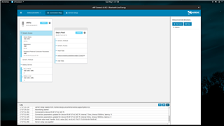

I purchased an nRF52840 Dongle to learn about BLE. I initially installed nRF Connect v2.6.0, installed the "Bluetooth Low Energy" App (v2.2.1), and successfully set up a very basic Server Setup with just a single Service and two Characteristics with Read, Write, and Notify properties. Everything worked well, as far as I could tell with my limited knowledge. I could change the value of each Characteristic from either the nRF Connect App OR my phone, no problem.

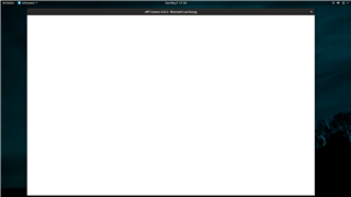

In any case, I can change the value of each Characteristic from nRF Connect (as before), but now... If I change the value on my phone and select "Send", the nRF Connect window on my computer goes completely blank (white window) and it seems like the dongle becomes unresponsive, as my phone loses connection with it and can no longer connect. The only way I can get it back is to close nRF Connect, remove and re-insert the dongle, and launch nRF Connect again.
Before... All OK
After... FAIL
