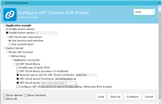

nRF9160 Cannot make Kconfig options have an effect in Segger Embedded Studio
I have a nRF9160 DK and I'm adapting the asset tracker to connect to our own AWS cloud solution.

How do I make changes to the Kconfig have an effect when building in Segger Embedded Studio? No matter what I do, changes to this Kconfig doesn't have an effect to the built result.

  • Hello Johan,
    In Segger Embedded Studio we can access these configs in the Project -> Configure nRF Connect SDK Project.
    Here you are able to change the configurations for your application.
    You can click through the different Configs or simply use the "filter" option at the top right to find things quicker.
    So in your case you want to address the Cloud Host name etc. just use "cloud" as filter and it should show the available configurations you can change.
    After your changes you can click the "Configure" button and then re-build your application with these changes.
    If you 'hover''  the cursor over the different names you will see their respectable kconfig names (and where they are located).
    e.g.
    "nRF Cloud server host name" = NRF_CLOUD_HOST_NAME
    This will be equal setting the configs in the "prj.conf" file in the application folder.
    If you want to change the NRF_CLOUD_HOST_NAME to something else than whats default, then you can add the following
    e.g.
    CONFIG_NRF_CLOUD_HOST_NAME="<new_host_name>"
    Martin L.

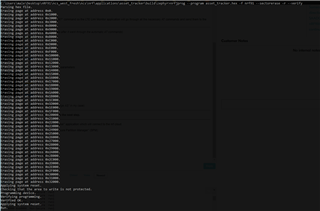

    3b) So we want to flash the application to non secure flash.
    - opening nrf-project te_ble_gateway
    - board = ns this time
    - cleaning solution
    - modified main.c (to print "Application 2..." instead, printk("Application2 started\n");
    - build and run
    - The debugger stops in disassembly instead of the c-code at address 0x00000f40 4040 eors r0,r0
    - The application isn't found by the bootloader it seems. It jumps to the wrong address.
    - Forcing it to run, makes it goto 0xEFFF FFFE   0000 moves r0,r0 - no code there either.
