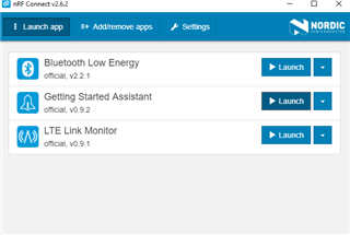

Please follow the Getting started Assistant in nRF Connect for Desktop. (Not the same as nRF Connect SDK (NCS)) After installing, please start the program and click "Add/Remove Apps". This menu will allow you to add the "Getting Started Assistant (v0.9.2)". Following the assistant will ensure that you have the latest version of NCS.
When compiling using the latest version NCS, both SPM and the sample you want to program are combined into one .hex (multi-image) file that you can program. See this link for more information information. Be aware that Segger Embedded Studio 4.16 does not support debugging multi-image projects,

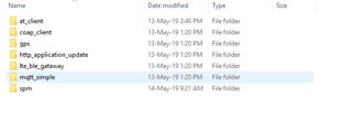

is this the one?

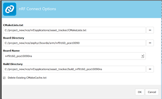

I was doing it with that option only and getting the error.

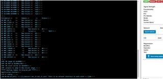

When I compile the asset tracker application using nrf9160_pca10090, I get the same error as you:
When I compile the application using nrf9160_pca10090ns, I get:
But I am doing it in non secure mode only and still getting the error.Why so?
Actually in both cases I get the errors.There is no difference in errors with and without "ns".
