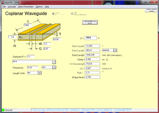

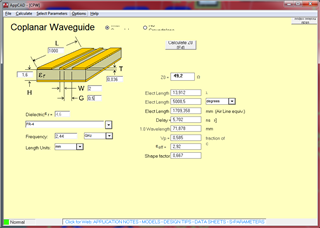

  • Well. For one, if I calculate the width of a 50Ohm transmission (eps=4.3, d_pcb=1.6mm) with a coplanar waveguide tool I get a result in the vicinity of 2mm which seems very large. None of the examples seem to have transmission lines that wide. So are those really 50Ohm or what's going on here?

    2mm width might seem quite wide, yes, but the impedance also depends on the gap between the line and the ground pour in the same layer. At ~0.5mm gap you should see about 50 ohms:
