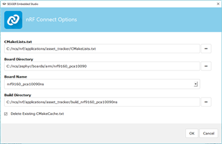

this is the load screen for the project

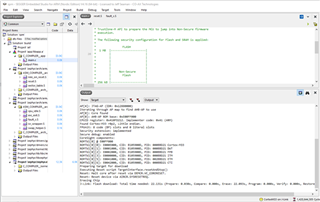

When I run the program I get the following on my terminal that keeps repeating the boot sequence.

SPM: NS image at 0x40000
SPM: NS MSP at 0xffffffff
SPM: NS reset vector at 0xffffffff
SPM: prepare to jump to Non-Secure image.

    My question is this - How do I modify the the asset tracker project to program the correct region? (I was running into this on the asset tracker)
    Second question is how do I get the debugger started if I can't get the project started correctly with the Build-> Debug and Run menu?

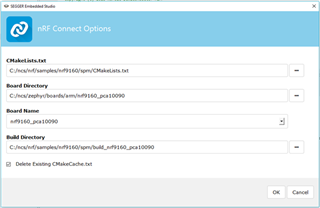

    Open the SPM project
    Then from the tool bar select Target>Connect J-Link
    Then in the target menu select Erase All to erase everything on the nRF9160.

    once the modem firmware has been programed we are ready to program SPM (Secure Partition Manager).  In Segger Studio navigate to main.c in the spm project now press the green arrow in the upper right corner of the editor paint to build and debug the program.
    Once you run the program you will get an error
    Preparing target for user application
    Executing Reset script TargetInterface.resetAndStop()
    Reset: Halt core after reset via DEMCR.VC_CORERESET.
    Reset: Reset device via AIRCR.SYSRESETREQ.
    Stopped by vector catch
    in the output window this is fine since there is no program in the non secure partition yet.
    Now in the file at_client/prj.conf add the line CONFIG_SPM=n.
