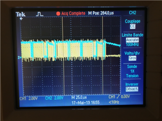

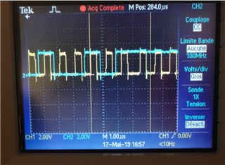

Also, I used an oscilloscope on SWDIO and SWDCLK in order to see the signals, this is what I got :
(the whole transfert)
(the clock)
Then, when I drag and drop the .hex file in the first board, the board reboot and the code is flashed
After the transfert, a new file named (FAIL.TXT) appear in the first board with the message "Error while connecting to CPU". So I think the Vtg is working and the second board is correctly detected (I tried to disconect the vtg pin and the clock did'nt work anymore). But the code is not flashed on any board.
