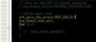

thanks! I use ble_app_blinky_c example and modify the code
,compile it with iar7.80.4 .and test dfu again .it work well.But the code I generated is 47KB, which is much larger than 6KB., I want to know what to do to reduce the file size so I can upgrade faster
Hi CBQ,
Please aware of the main difference between the ble_app_blinky_c and the blinky example. The ble_app_blinky_c is a BLE application, which can connect to other blinky app.
The blinky example only do LED toggling.
I strongly suggest you to get familiar with the nRF52 chip, how to write a normal program with it, how to blink LED with it, before you start playing with mesh application.
