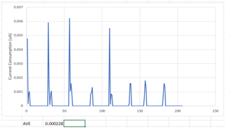

Do you have any suggestions on how I can lower the power consumption. I am currently connecting - sending data - disconnecting.
I have the following set the parameters as: Min/Max Interval = 15/15, Slave Latency = 0, Timeout = 3000 ms.

  • The whole board (including the uC,nrf, and accel) consumes an average of 400-500uW for 30 cycle time, but I need to lower down this to around 200uW. I have this cycle: wakeup - connecting - sending data - disconnect - sleep and I measure a peak of 6mA (drawn by the nrf8001).
    One other option that I am thinking is to keep the connection during the 30 cycle time rather than connect - sending - disconnect. Because I think that advertising must be consuming more power. Will you have any suggestion for this?

    I used the nRFgo studio for the average current consumption, and theoretically I should be getting  ~133uA in average.
    nRFgo studio
    However, when I tested it, I got about ~230uA in average. Yes, I have observed that nRF8001 draws less than 500nA while in deep sleep. My concern is that there is a high peak during advertising which peaks ~6mA. And also, there are instances where I do not see the peak, but I do not understand why.
    Actual Current Consumption
    Would you have any recommendation to further lower down the current consumption? Thanks!
  • How are you measuring this? looks like the sampling rate might be to low to properly measure the current consumption. Spikes during radio activity is normal as that would require a lot of power.
