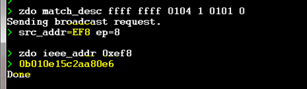

I tried to follow this example to test and I can get a response w/ "zdo match_desc ffff ffff 0104 1 0101 0".
And the following step can on/off the BSP_LED_3 for door lock/unlock when the first test operation.
But when I power off the EVB both and power on to test again, I cannot get the response w/ the command "zdo match_desc ffff ffff 0104 1 0101 0" in 2nd-time operation.
Now I tried to eraseall and re-program the flash, and I can get the response w/ command "zdo match_desc ffff ffff 0104 1 0101 0".
But it doesn't make sense to do re-test w/ erase flash and program every time.
How do I re-test this example without an erase flash and program image?

    I erase / program and test again, the log as below.
    I power off/on for both device before 2nd run test.
    > bdb role zc
    Coordinator set
    Done
    > bdb start
    Started coordinator
    Done
    > zdo match_desc ffff ffff 0104 1 0101 1 0
    Sending broadcast request.
    > src_addr=A30 ep=8
    > zdo ieee_addr 0xa30
    > 0b010e15c2aa80e6
    Done
    > zcl cmd 0b010e15c2aa80e6 8 010 1 1 -p 0104 00
    > Done
    > zcl cmd 0b010e15c2aa80e6 8 0101 -p 0104 00 1
    Done
    > Done
    > bdb role zc
    Coordinator set
    Done
    > bdb start
    Started coordinator
    Done
    Done
