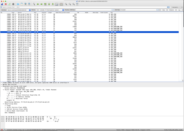

I've got Wireshark running with nRF Sniffer, but it is not really working for me.
I'm using a PCA10040 board as the sniffer hardware.
I'm running on a Mac with MacOS 10.14.4.
I'm running Python 2.7.10 and I installed PySerial 2.7.
I downloaded nrfsniffer200beta312oct20181c2a221.zip.
I installed the hex file for PCA10040 onto the board.
I installed the nRF profile into Wireshark and installed the python scripts into the extcap folder.
Note that I first installed Wireshark 3.0.2 and then downgraded to 2.6.9, which did not affect my issue.
When I run Wireshark, I can select the nRF sniffer profile and I can select the interface to my sniffer board. I see all of the advertising data for all devices, but when I select a specific device from the Device popup menu, it does not affect the output. I still see all of the advertising data. If I select my device and connect to it from my iPad then I see the advertising stop for my device, but I continue to see the advertising packet for all of the other devices in my area. Also, I only see advertising data. It does not show any other packet types from my device.
Here is the log window contents after selecting my device.
INFO: Log started at Fri May 31 15:37:30 2019
INFO: args: ()
INFO: kwargs: {'callbacks': [('*', <bound method Sniffer.passOnNotification of <Sniffer(Thread-2, initial)>>)]}
INFO: board ID (random): 156
INFO: starting scan
INFO: starting scan
INFO: Sent key value to sniffer: [0, 0, 0, 0, 0, 0, 0, 0, 0, 0, 0, 0, 0, 0, 0, 0]
INFO: Sniffing device 13 - ""Sm""
INFO: Following "Sm" f7:73:bf:4a:a6:c3 random
It says it is following my device, but it is still following all devices.
Any help is appreciated.

  • If you meant a capture log, here's a screen shot showing advertising data. You can see the selected device "Sm" is my device, but the advertising packets are still all devices. I have one of my device packets selected, so you can see its data in the details pane. I never see any connect packets, which I guess is because the device selection just isn't working.
    Advertising data
  • One big difference, of course, is that you are using the Windows version and I am using the MacOS version.
    Another thing I noticed is that you show a dialog I had not seen before. It's titled Interface Options. In searching for that dialog, I see there is actually a small icon next to the nRF Sniffer interface list. I do get that same dialog when I click on it. It has the same choices as in your screen shot. Oddly, I have a number of issues with it that prevent me from doing anything useful with it. For example, I tried clicking on the Restore Defaults and later the Only advertising packets checkbox, just to see if I could jog it into doing something different. Instead, I get weird behavior.
    If I click the Start button, it starts the capture just as if I had double-clicked the interface. Neither of the options seems to affect what happens. However, the default Device is All advertising devices. When I try to select my device from this list, which you cannot do until you start capturing advertising packets, I can't interact with any of the controls in the Wireshark interface. If I simply start typing on the keyboard, the text shows up in the filter field, but clicking on anything else anywhere in the Wireshark window produces a "ding" sound, indicating the mouse click is being ignored. It's as if I'm stuck in a modal dialog and the filter field has the UI focus. I can't even access the Quit menu item, so the only thing I can do is quit the app from the OS. Once I do that, I get a save dialog. If I click the Cancel button then I regain control of the UI.
    To me, it seems like the Python scripts just aren't doing a good job of talking to the MacOS or to Wireshark in presenting the UI for the tool. The capture itself seems to work fine. I get lots of packets. I just can't seem to get the UI options to affect the output. It really looks like a MacOS related issue.
