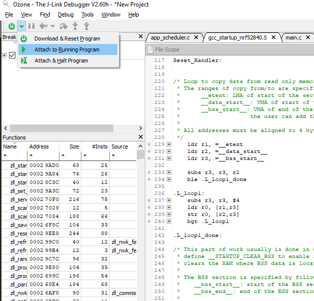

What is the right way to use the debug possibilities of Segger Embedded Studio (or another allowed IDE) in case of the client Zigbee OTA upgrade application example? For now, I am using the NRF_LOG_INFO macros messages through the RTT Viewer. But is it possible to debug the client application “in a full manner”, I mean using the breakpoints, step into/over, etc.?
If yes, could you please advise me, how can I reach it?

    I have not been able to debug in SES yet, but I have been able to set up a debugging session in Ozone.
    I ran the following script from the ota folder:
    make -j -C bootloader_debug\pca10056\blank\armgcc
    make -j -C client\pca10056\blank\armgcc
    nrfutil settings generate --family NRF52840 --application client\pca10056\blank\armgcc\_build\nrf52840_xxaa.hex --application-version 0x01010101 --bootloader-version 1 --bl-settings-version 2 --app-boot-validation VALIDATE_ECDSA_P256_SHA256 --key-file priv.pem settings.hex
    mergehex -m client\pca10056\blank\armgcc\_build\nrf52840_xxaa.hex settings.hex -o dfu_client.hex
    nrfjprog -f nrf52 -e
    nrfjprog -f nrf52 --program mbr_nrf52_2.4.1_mbr.hex --chiperase
    nrfjprog -f nrf52 --program bootloader\pca10056\blank\armgcc\_build\nrf52840_xxaa_mbr.hex
    nrfjprog -f nrf52 -r --program dfu_client.hex --sectorerase --snr 683357357
    nrfjprog -r
    Then I opened Ozone and selected the .out file in the client folder (client\pca10056\blank\armgcc\_build\nrf52840_xxaa.out)
    Instead of downloading the file I selected "Attach to Running Program"
    And I was able to step through the code.
    Hope this helps you.

    It is great! Thank you very much.
