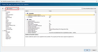

     And, I agree that the section is not written for SES. I will try to guide you through the steps, and hopefully get you up and running. A good start is to compare settings in PCA10040 vs PCA10040e. The following steps show how to open the configuration. Also, have a look at the Developing with SES - Getting Started Guide (pdf).
    In SES, make sure to click on the project in project items:
    Now, in the menu, click Project -> Options. This opens the Project Options. Make sure to choose Common settings:
    Next, we'll go through the steps from the User Guide. See my comments in bold.
    1. In the project settings, change to device "NordicSemiconductor->nRF52810_xxaa".
      • NordicSemiconductor does not apply, but in the search field type: nrf
      • This should give some alternatives to where NRF52 and NRF52832_XXAA are defined.
      • Debugger - Target Device: Double click on value and choose nRF52810_xxAA
      • Please make sure to compare PCA10040 vs PCA10040e project options
    2. In the C/C++ preprocessor settings, remove the defines "NRF52" and "NRF52832_XXAA".
      • See answer above, in Preprocessor Definitions not C/C++ preprocessor settings
    3. Add the preprocessor define "NRF52810_XXAA".
      • Preprocessor Definitions, add NRF52810_XXAA
    4. In the linker script settings, adjust the linker script to match the maximum RAM and flash size of nRF52810.
      • ROM END: 0x2FFFF
      • RAM END: 0x20005FFF
      • The two above does not apply, instead: Under build -> memory segments (searh segments)
        • FLASH RX 0x0 0x30000
        • RAM RWX 0x20000000 0x6000
      • Copy Section Placement Macros from PCA10040e
      • EDIT: Please see this tutorial
    And of course, remember to do step 6 and 7.
    Let me know how this works for you!
    Øyvind
