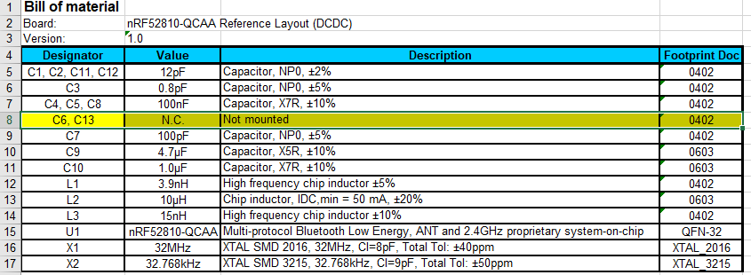

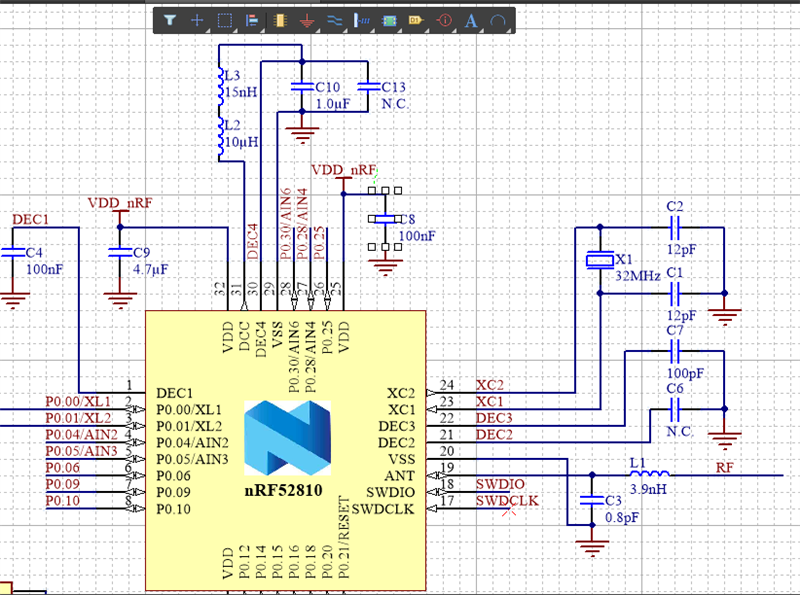

I'm using the nRF52810-QCAA (DCDC) Reference Design, but I've noticed that C6 and C13 are labeled as No Connected in both the schematic and BOM, but in the PCB model, they are actually mounted, why?
Can I safely remove them from my design or do I have to keep them?
