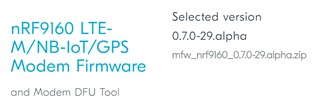

I'm trying to update the firmware on my nRF9160 development kit
I downloaded the modem firmware and DFU tool
And then tried to follow these instructions:
However, when I run nrf9160_mdm_dfu --update
I get the following:
