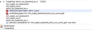

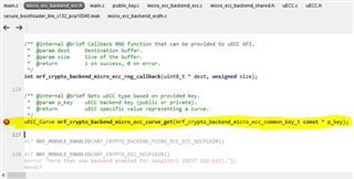

    I have compiled uECC.c file successfully as per your direction thanks for that. But while building the
    "secure_bootloader_ble_s132_pca10040" bootloader file getting errors ( attached below). What should I change?  As they have declared as typedef -- like-->
    "struct uECC_Curve_t;
    typedef const struct uECC_Curve_t *uECC_Curve;"                in uECC.h file
    Error is in “micro_ecc_backend_ecc.h”   file
    How can i solve this errors.  I am using the Segger embedded studio for ARM V4.16 here as IDE for nRF52 DK.
    Please reply.
