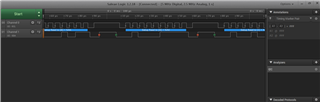

also the I2c clock frequency, as shown in below image, while i am capturing data when i observe in oscilloscope or logic analyzer , clock frequency is showing 200 all the setting is for 400KHz.
what could be the problem for this or is there any other way i need to follow to set the clock to 400KHz.

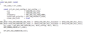

  • "also the I2c clock frequency, as shown in below image, while i am capturing data when i observe in oscilloscope or logic analyzer , clock frequency is showing 200 all the setting is for 400KHz."
    That's unlikely, I think you're measuring the clock frequency incorrectly.
    Why have you enabled pulldowns on your IO pins?
  • actually that's not the part of code , sorry excluding that is the actual code

    The above code is without softdevice enabled still the same issue, as u can see in line 129 400k is set
  • how did u say this macro in 944 th line is 400, isn't it how u set the clock.
  • If you use the 'default' config you can use sdk_config.h to choose the settings, but you can also just grab the settings definitions from the HAL.
  • This code is a lot easier to read, thank you.

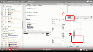

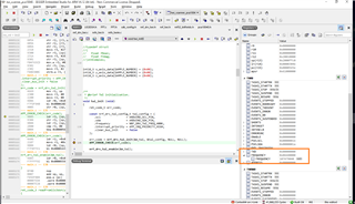

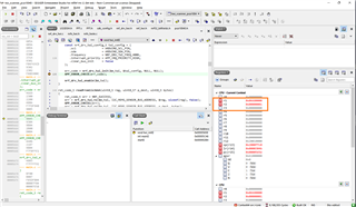

    I suggest you halt the CPU and read the TWI/TWIM registers. This will tell us what configuration is actually set in the TWI peripheral. If the FREQUENCY is set to 0x06680000 (400khz) then the root cause is most likely outside the MCU, and if it is not then the TWI peripheral has not been configured correctly in SW.
  • how to read TWI/TWIM registers, if not configured how to configure it.
