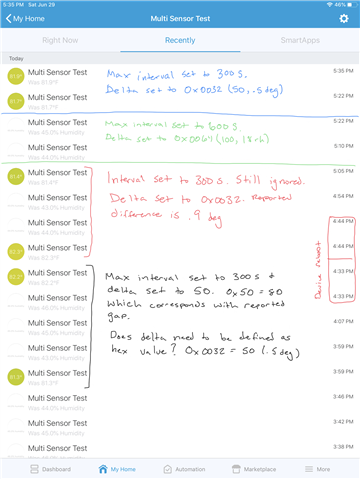

With the device now configuring attribute reporting I seem to have fixed the problem above in that now between attribute updates (every minute), the device uses the long poll interval when sleeping unless an attribute is to be reported (without having to issue an attribute report configuration through SmartThings). This now leaves me with another set of issues that have me scratching my head a little.
  1. The temperature attribute to update every half degree with a maximum interval of 300 seconds. The problem, that is illustrated in the attached image, is that I am getting random reporting intervals that seem to completely ignore maximum interval.
    1. While writing this post it occurred to me that I am working with temperature in celsius on the device and it is translated to fahrenheit in SmartThings. I was expecting half degrees F, not C (doh).
  2. Relative humidity is configured to report every 600 seconds or every 1%. Again, the maximum interval appears to be ignored.
  3. Battery remaining percent changes too infrequently for me to have any data but given the points above I think I can safely assume it does not work as I want it to.

  1. When configuring the reporting value delta should we be using the hex value or integer value? I am leaning towards a hex value based on the observations in the above image and when configuring reporting in SmartThings, they use a hex value. Which is correct?
  2. What could be the cause of my maximum interval being ignored? I am wondering if just because I am configuring reporting locally to the device perhaps the central is not acknowledging it. I'm guessing a "re-binding" needs to occur on the central for reporting.

    Unless I have completely missed the boat, the device should be reporting any value when the maximum interval has been reached. Prior device behavior had attribute reports coming in no later than the maximum interval consistently.
