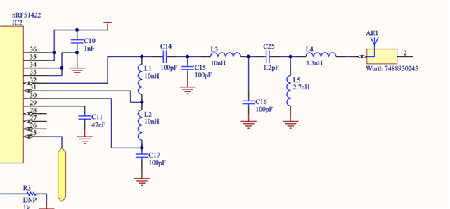

nrf51422 antenna matching network components
I am using the nRF51422 for BLE data. My antenna matching network is this:
However, compared to the DK I am getting lower gain (DK gives -50, my PCB gives -64). I have laid out the components on the pcb exactly as provided by the reference guide and done the same for the antenna based on the antenna's manufacturer. Thus I was wondering what is going on with this matching network and would appreciate any help.
