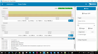

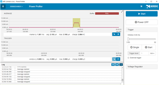

I need to minimize current consumption when using FreeRTOS. I have merged freertos with the ble_app_uart example using SDK 15.3.0. I am getting the average current as 9.162 uA when FreeRTOS is configured with NRF_LOG_ENABLED set to 0. The FreeRTOS ticks I guess approx. at 1 sec. I want to reduce this 1 sec time to msec so what changes I need to do? I am testing on nrf5283 development board. I have attached two images: image uart_freertos_4.png showing time between the ticks which I want to change, and uart_freertos_3.png giving the average current consumption which I want to reduce it as close a s 2-3 uA.
    Increasing the frequency of the FreeRTOS ticks will not minimize the current consumption. Have you done the steps mentioned in this guide?

  • yes, Jared I have done the steps that are mentioned in the guide. I got the desired low current consumption when freeRTOS was not merged. But after adding freeRTOS I am not able to get the low current.
  • Hi @sara,
    I was banging my head for several weeks on a similar phenomena (in SDK 14.2)
    Apparently, there is a shortcoming in freeRTOS power optimization.
    See this post for details and workaround.
    I Hope this helps.
    Good luck.
