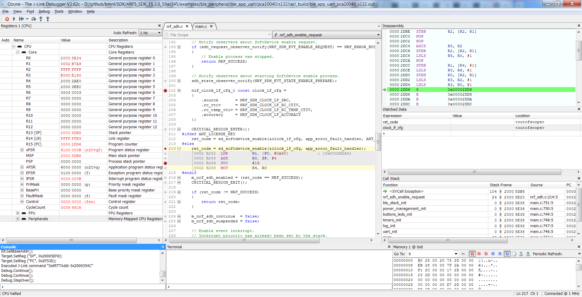

However suddenly today the examples stopped working even though using the same hardware board. The problem occurs while initializing the BLE stack where in a call to function sd_softdevice_enable is made to enable the softdevice. However the function never returns ( any error code ) and seems to be halted at an sv call to #16 (in assembly, this is a branch instruction to address 00002DD6 at PC with address 00002DD6). Below are two debug screenshots from Ozone which display the problem.
First screenshot just before the svc call is made.
Second screenshot just after the svc call is made (step over resulting in halt).
 second screenshot just after the svc call is made (step over resulting in halt)

    Looks like the data at address 0x0 may have been overwritten. The first word should for instance have been 0x20000400 (initial stack pointer), not  0x20002890 as shown in Ozone. Try to re-program the Softdevice with nrfjprog and see if you run into the same problem.
    e.g.,
    1. nrfjprog --program <sdk>/components/softdevice/s132/hex/s132_nrf52_6.1.1_softdevice.hex --sectorerase -r
    2. nrfjprog --readregs // prints out CPU registers so you can check if the PC is stuck at 0x2DD6

  • I followed the steps by hmolesworth and first time downloaded&debug I saw some sort of exception. I tried second time downloaded&debug and then it works.
    Aside, I wonder how did this problem occur in the first place because I didn't change any settings or procedure.
    Thanks a lot for detailed advice to both  and .
