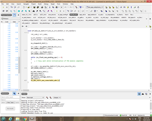

on button press eddystone starts connectable adv...as the below function says..
but again take a look at function below
nrf_ble_es_init(on_es_evt); is called in main()
then whatdoes this "es_adv_start_non_connctable_adv();" function means.....????
does this starts a non connectable adv..???
if yes the why we stay connected in app???
