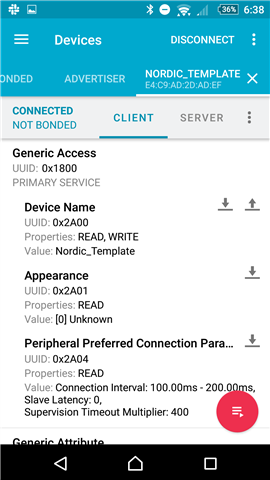

Hi I am using the nRF51 DK and I successfully ran the ble_app_template program from examples\ble_peripheral in SDK v10. Using the nRF connect app I am able to do both read and write values.
I want to try creating other services and setting different values for characteristics in the ble_app_template program. For example I want to change the value from '[0] Unknown' to 'Hello' for the Appearance (0x2A01) characteristic. But I cannot find where the default BLE services, characteristics, attributes are initialized and defined in the ble_app_template program. I am using Keil 5 and I tried searching the ble_advdata.c, ble_advertising.c, ble_srv_common.c files, etc from nRF_BLE folder. None of the files I searched had code that mention the Generic Access Service (0x1800) or Generic Attribute (0x1801) services.
Where should I look to find the code that initializes/defines these services, characteristics, and default values?

    1. No, you can use any other method of your choice for generating a 128 bit base UUID.
    2. Yes. The BLE specification doesn't use names (characters) for identifying services and characteristics but rather UUIDs. In nRF Connect we can identify certain services and characteristic if they use a predefind16 bit UUID (such as the heart rate service) , and certain 128 bit custom UUID (such as NUS). nRF Connect mobile app have the option of displaying a name for a custom service after you've connected to the peripheral. The 16 bit UUID you would add to your custom base UUID can be generated as you chose.
