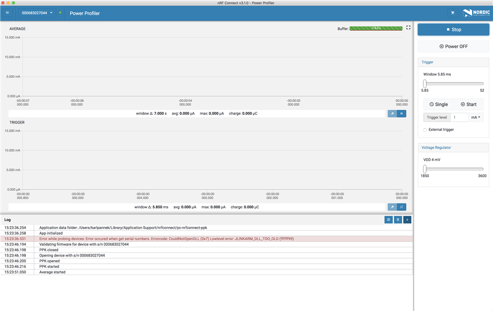

  • Hi there,
    I am also trying to do some power profiling. I have exactly the same setup, except for running the app on macOS.
    I connected the DUT like shown in Figure 1 (using the onboard regulator) and the DUT receives power and switches on,  but I get the same result as @userkan:
    - LED2 on the PPK (which indicates connection) is not lit.
    - Connection state on the Power Profiler Application seems as connected but actually no data flows between the kit and the application in either direction.
    - When I power ON/OFF the DUT from Power Profiler Application nothing changes in hardware (External DUT is always powered)
    - When I change the voltage of the regulator from Power Profiler Application nothing changes in hardware.
    - No current readings are displayed on Power Profiler Application when I capture data.
    - Everything on the console of the Power Profiler Application seems normal as you can see on the attached screenshot.
    Here is a screenshot of my app:
  • Very sorry for the delayed response. Have you tried putting the power switch SW4 on the PPK in DK position instead?
