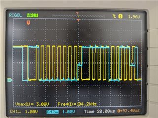

    scope 'screenshot':
    you can see that SDA (blue) is held at VCC/2 during the ACK bit because both the NRF and the sensor are trying to drive the pin high/low, resulting in a short.
