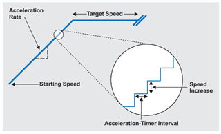

  • Sorry, I should have given some more details. As I get it, the speed is controlled by the frequency of the square wave. There are several examples using pwm driver for instance where duty cycle is controlled, but here I want a fixed 50% duty cycle and increasing/decreasing frequency. The challenge, I guess, is to find a solution that minimizes the involvement of sw, controlling the frequency of the pulses, with possibilty of acc/deccl, and also keeping track of the exact pulses sent

  • An update of the progress...
    For now, I have accepted that it will be difficult to achieve this without sw intervention during acc/deccl. I have made an example with a different approach;
    I use PWM driver to generate the pulses in different phases; acceleration phase, target speed sphase and decceleration phase. For acceleration and decceleration phases, I generate a single pulse and re-triggers with updated frequency from ISR until desired pulses and end frequency is obtained. For the target speed phase, I simply start PWM with the static target frequency and a specific number of repeats until ISR is triggered. The different phases will start each other after they finish. Apart from a higher cpu load this works acceptable for now.
