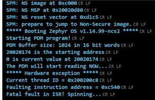

So this is a small continuation of this ticket https://devzone.nordicsemi.com/f/nordic-q-a/50656/using-pdm-mic-on-nrf9160dk.
The problem I'm having now is that when I run my program basically just using nrfx_pdm_start() I get a hardware exception error.

This seemingly only happens when the start command executes.
Any help is appreciated,
Thank you
