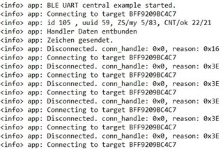

Test with 2 ble_app_uart_c, 1 ble_app_uart: Within 1hour one of the ble_app_uart_c crashes in error. Before this happens it connects many times and will be disconnected with reason 0x3e.
Test with 3 ble_app_uart_c, 1 ble_app_uart: Within 10min one of the ble_app_uart_c crashes in error. Before this happens it connects many times and will be disconnected with reason 0x3e.
Test with 10 ble_app_uart_c, 1 ble_app_uart: Within 1min one or more ble_app_uart_c crashes in error. Before this happens it connects many times and will be disconnected with reason 0x3e.
It seems that the ble_app_uart peripheral stores connecting parameters and decline connection. But this contradict to functioning over minutes with many ble_app_uart_c and hundreds of connectings-and-transmissions till one after the other ble_app_uart_c crashes. Any idea?
    Error code 0x3E means BLE_HCI_CONN_FAILED_TO_BE_ESTABLISHED, i.e. the connection request packet is not receive by the peer side. If multiple ble_app_uart_c tries to connect to the ble_app_uart at the same time, then this could happen. Also see this post.

  • because the peripheral can only connect to one and it is connected to the first.
    Correct, but several centrals could be trying to connect to the same peripheral at the same time. This is when you get this issue.
    You could try to lower the value of APP_ADV_INTERVAL, and see if that improves anything.
    If you get 0x3e, just restart the scanning.
    Depending on what type of application you are creating, an alternative approach, could be to advertise the data instead (update the data for each advertising packet). Several centrals could then get the data at the same time. If that is not desired, there are also ways to reduce the connection time, e.g. by skipping the service discovery
