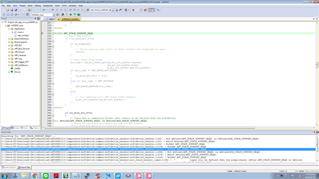

    i'm using "cycling speed and cadence" on DK to make a test run. However, my bicycle-watch(base on ANT) doesn't receive any "ANT signal".
    Searching in the devzone, i got the information here, and according to the reply of this page (here), i tried to find out how "ANT_STACK_SUPPORT_REQD" was defined. Unfortunately, the following picture was the screen shot of the example code "ble_app_rscs" from the SDK 13.1.0, which still cannot give me the answer.
Could anyone point it out where my fault is? Or some config should i set first?
