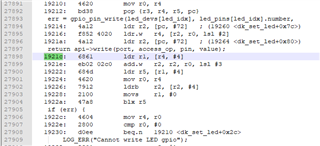

    I fixed the error. After moving the whole directory to the c drive root instead of using all these sub folders.
    After writing the hex file to the thingy:91 this is the serial output. Did messed something up with the certificates?

    2019-09-23T13:01:06.625Z DEBUG modem << [00:00:04.342,193] <err> os: Exception occurred in Secure State\x0D
    2019-09-23T13:01:06.633Z DEBUG modem << [00:00:04.342,224] <err> os: ***** HARD FAULT *****\x0D
    2019-09-23T13:01:06.635Z DEBUG modem << [00:00:04.342,224] <err> os:   Fault escalation (see below)\x0D\x0A
    2019-09-23T13:01:06.640Z DEBUG modem << [00:00:04.342,254] <err> os: ***** BUS FAULT *****\x0D
    2019-09-23T13:01:06.645Z DEBUG modem << [00:00:04.342,254] <err> os:   Precise data bus error\x0D
    2019-09-23T13:01:06.650Z DEBUG modem << [00:00:04.342,254] <err> os:   BFAR Address: 0x50008120\x0D

    Have you tried with version v1.0.0 of ncs?
    Also, to get more information about when the hard fault happened, you can open the file /build/zephyr/zephyr.lst and search for your faulting instruction address, which is 1921c in the output above.
  • Yes, I'm already on v1.0.0.
    To be honest, I've no idea what this tells me:
    Tim
  • Hi Tim,
    This tells you that it fails at
    return api->write(port, access_op, pin, value);
    If you scroll up, you will see which function it fails in, which I assume is the following:
    static inline int z_impl_gpio_write
    It seems like the problem might be related to nRF9160DK and Thingy:91 having different pinouts, considering the project was originally written for the DK. I would assume that the LEDs are the problem, so one possible fix is to remove all instances in main.c where the following function is called
    dk_set_led_on()
    Let me know whether this works.
    Best Regard,
    Marte

  • Hi Marte,
    this did the trick! Now it is not crashing anymore. Grimacing
