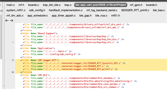

4) Things were more complicated when I tried to add a UART peripheral driver. I started by including the app_uart.h into my main.c
Needless to say how many files I had to look for in the SDK folder to manually include them into the User Include Directories. Moreover I ended up importing some other .c files which I don't know what they do, so I can sort them out properly.
Is there any more elegant way to do that?

    The attached is the folder.
    The error is caused by the path of the external folder inside the .emProject file.
    <folder Name="nRF_Segger_RTT">
    <file file_name="./../../../../external/segger_rtt/SEGGER_RTT_Syscalls_SES.c" />
    <file file_name="./../../../../external/segger_rtt/SEGGER_RTT.c" />
    <file file_name="./../../../../external/segger_rtt/SEGGER_RTT_printf.c" />
    </folder>
    The attached is the working folder at my side.
    nrf51_SES.zip
    you need to place it at SDK12.3/example/
