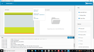

    After flashing bootloder and softdevice the flash memory layout look like below
    And its advertising as "DfuTrag" too.
    Please check by yourself man that the bootloader is fit for 512 kb and also try to make a zip file with all the condition i mentioned and try to upload to a DK which is flashed with SD and BL of sdk 14.2.
    In our case after doing the OTA -DFU its not advertising . i don't known why.
