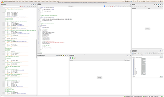

    I will dive into ble_app_uart! I've succeeded in building and flashing the app to my nRF52 dev kit (using pca10040e and S112). I'm able to connect from iOS device using nRF Toolbox and send data to the nRF52832 (emulating nRF52810).
    My initial issues are:
    1 - Logging does not write to the debug terminal. See separate post.
    2 - If I flash and start debugging but I don't connect to the peripheral (peripheral remains advertising), after about 3 minutes, will fault on NRF_BREAKPOINT_COND. I've attached screen shots of launched app, then fault. Maybe related to an advertising timeout or something of the sort?
