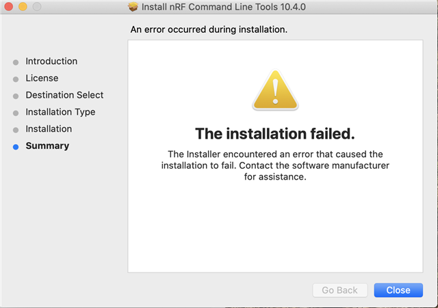

  • Also, When I tried to install, nRF-Command-Line-Tools_10_4_0_OSX, it fails.
