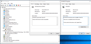

I have tried to connect Nordic Thingy91 (nRF9160) device using "nRF connect v3.2.0", via USB.
But I am facing, below issue.
Issue 1: "unsupported device: the detected device could not be recognized as neither jlink device nor nordic USB device for windows 10"
Tried: I have tried installing different versions of J-Link from below:
www.segger.com/.../
(Tried with: 6.22g,e 6.50e, etc.,)
But no luck, and below issue is seen,
Issue 2: "unsupported device with serial number PCA_20035_d081421f4d65 and trails ["serialport"]"
Is JTAG necessary to flash/program the "nRF9160" and "nRF52840"..?

    As per the directions above, I have checked out the v1.1.0 branch and built a sample code as follows.
    cd ncs/nrf
    git checkout -b v1.1.0
    git branch
    master
    * v1.1.0 ==> I am in v1.1.0 branch.
    cd ncs/nrf/samples/usb/usb_uart
    west build -b nrf52840_pca20035
    --> Build was success, and I am ready to burn the nRF52840 (PCA20035) with app_update.bin/merged.hex on thingy91 device using "mcumgr" (mcumgr --conntype=serial --connstring=COM image upload <image>).
    --> But, could you please let me know, is there any possible way that I can bring back nRF52840, if MCUBoot flash fails with "mcumgr"...!!
    As I don't have nRF DK(pca10090)/JLink to bring it back externally.
