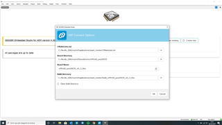

Hi everyone, I successfully followed all the steps of the Getting Started Assistant on Windows 10 x64, but I am unable to open the Asset Tracker project because of some errors (see attachments).

I changed the "hub==2.0" line to "git-spindle==2.0" in the "requirements.txt" file located in "...\ncs\zephyr\scripts\" as listed here https://devzone.nordicsemi.com/f/nordic-q-a/51051/nrf-connect-sdk-install-issue-hub-2-0-not-found-leading-to-build-errors .
GNU Arm Embedded Toolchain is version "7 2018-q2-update".
I used ncs tag "v1.0.0".
If I select nrf9160_pca10090 board it all goes well, but I have to use nrf9160_pca20035 because I have a Thingy:91.
What's going wrong?
Thanks in advance.
  • Hi.
    The Thingy:91 is not supported in ncs tag v1.0.0, could you try with master?
    Also, I think you might have to build with command line in master, as SES has some issues with that at the moment.
