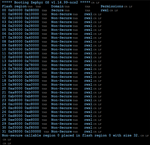

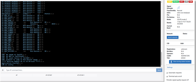

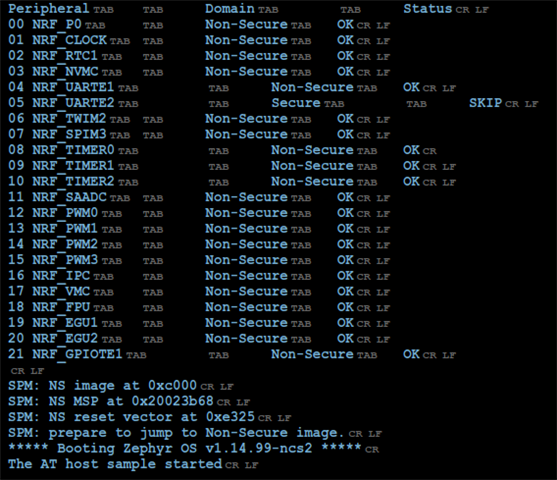

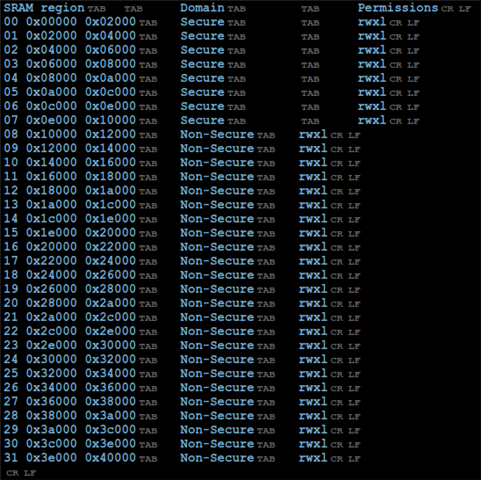

    thank you. I did power cycle a few times. This is the output from the at client example.

  • Thank you. Yes, the first one was Telenor, this is iBasis.
    With iBasis, the Modem, UICC, LTE and PDN bars all turn green after the second "AT+CFUN?" command. With Telenor, only the Modem bar turns green.
    2019-11-06T10:24:26.547Z DEBUG modem << ***** Booting Zephyr OS v1.14.99-ncs2 *****\x0D\x0A
    2019-11-06T10:24:26.552Z DEBUG modem << The AT host sample started\x0D\x0A
